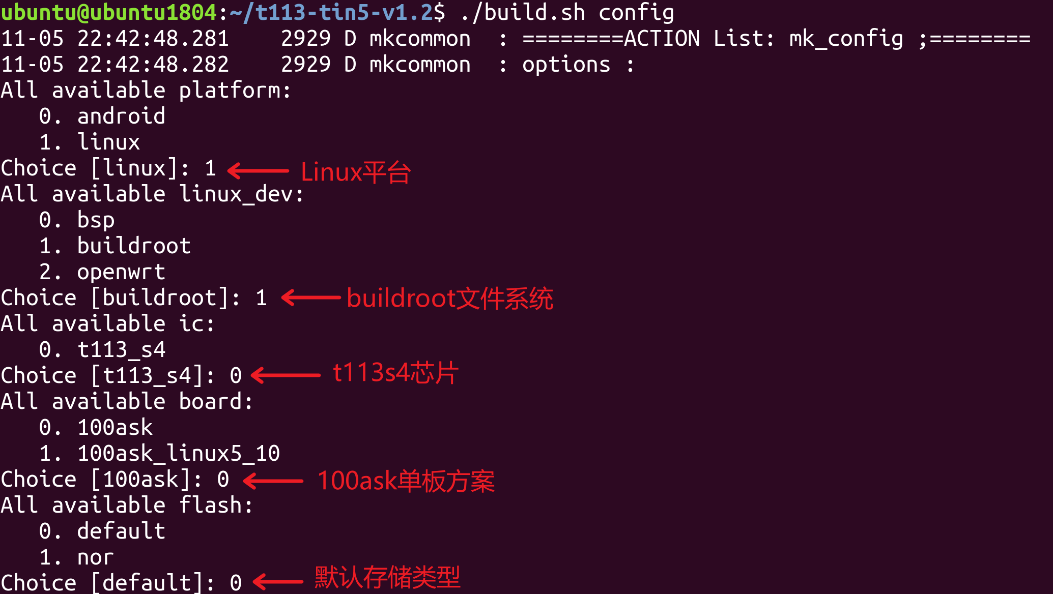

首次编译需要配置单板选项:
./build.sh config
根据提示依次选择:
All available platform:
0. android
1. linux
Choice [linux]: 1
All available linux_dev:
0. bsp
1. buildroot
2. openwrt
Choice [buildroot]: 1
All available ic:
0. t113_s4
Choice [t113_s4]: 0
All available board:
0. 100ask
1. 100ask_linux5_10
Choice [100ask]: 0
All available flash:
0. default
1. nor
Choice [default]: 0
