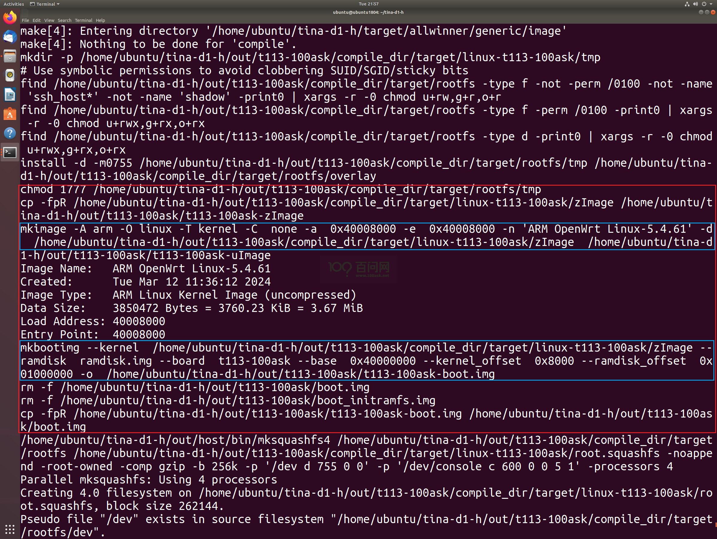

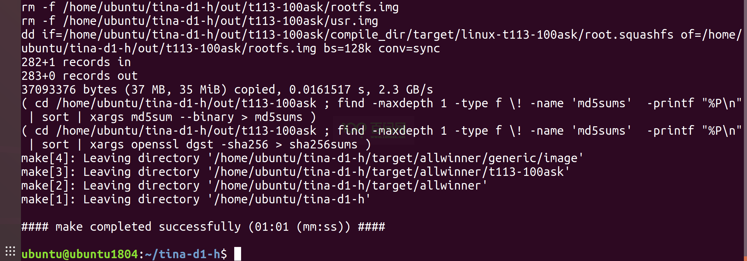

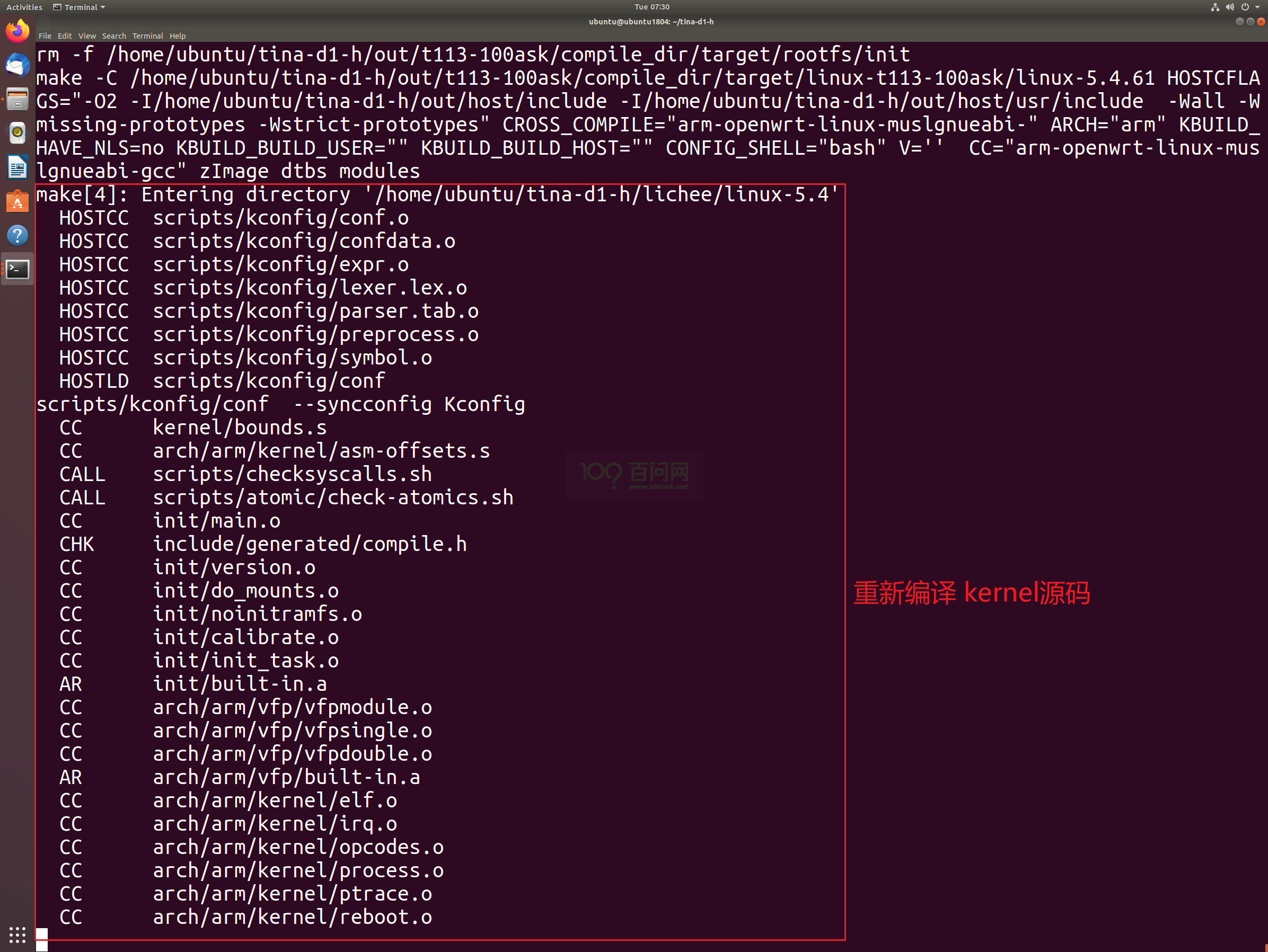

单独编译kernel​
前面介绍,在TinaSDK 环境内,单独编译 Linux kernel只需要 mkernel一个命令即可,如下图所示:
ubuntu@ubuntu1804:~/tina-d1-h$ mkernel
===This's tina environment.===
special target, skip mboot,marisc
make[1]: Entering directory '/home/ubuntu/tina-d1-h'
make[2]: Entering directory '/home/ubuntu/tina-d1-h/target/allwinner'
make[3]: Entering directory '/home/ubuntu/tina-d1-h/target/allwinner/t113-100ask'
/home/ubuntu/tina-d1-h/scripts/kconfig.pl + /home/ubuntu/tina-d1-h/target/allwinner/generic/config-5.4 /home/ubuntu/tina-d1-h/device/config/chips/t113/configs/100ask/linux/config-5.4 > /home/ubuntu/tina-d1-h/out/t113-100ask/compile_dir/target/linux-t113-100ask/linux-5.4.61/.config.target
awk '/^(#[[:space:]]+)?CONFIG_KERNEL/{sub("CONFIG_KERNEL_","CONFIG_");print}' /home/ubuntu/tina-d1-h/.config >> /home/ubuntu/tina-d1-h/out/t113-100ask/compile_dir/target/linux-t113-100ask/linux-5.4.61/.config.target
echo "# CONFIG_KALLSYMS_EXTRA_PASS is not set" >> /home/ubuntu/tina-d1-h/out/t113-100ask/compile_dir/target/linux-t113-100ask/linux-5.4.61/.config.target
echo "# CONFIG_KALLSYMS_ALL is not set" >> /home/ubuntu/tina-d1-h/out/t113-100ask/compile_dir/target/linux-t113-100ask/linux-5.4.61/.config.target
echo "CONFIG_KALLSYMS_UNCOMPRESSED=y" >> /home/ubuntu/tina-d1-h/out/t113-100ask/compile_dir/target/linux-t113-100ask/linux-5.4.61/.config.target
/home/ubuntu/tina-d1-h/scripts/metadata.pl kconfig /home/ubuntu/tina-d1-h/tmp/.packageinfo /home/ubuntu/tina-d1-h/.config 5.4 > /home/ubuntu/tina-d1-h/out/t113-100ask/compile_dir/target/linux-t113-100ask/linux-5.4.61/.config.override
/home/ubuntu/tina-d1-h/scripts/kconfig.pl 'm+' '+' /home/ubuntu/tina-d1-h/out/t113-100ask/compile_dir/target/linux-t113-100ask/linux-5.4.61/.config.target /dev/null /home/ubuntu/tina-d1-h/out/t113-100ask/compile_dir/target/linux-t113-100ask/linux-5.4.61/.config.override > /home/ubuntu/tina-d1-h/out/t113-100ask/compile_dir/target/linux-t113-100ask/linux-5.4.61/.config.set
rm -f /home/ubuntu/tina-d1-h/out/t113-100ask/rootfs.img
rm -f /home/ubuntu/tina-d1-h/out/t113-100ask/usr.img
dd if=/home/ubuntu/tina-d1-h/out/t113-100ask/compile_dir/target/linux-t113-100ask/root.squashfs of=/home/ubuntu/tina-d1-h/out/t113-100ask/rootfs.img bs=128k conv=sync
282+1 records in
283+0 records out
37093376 bytes (37 MB, 35 MiB) copied, 0.0216129 s, 1.7 GB/s
( cd /home/ubuntu/tina-d1-h/out/t113-100ask ; find -maxdepth 1 -type f \! -name 'md5sums' -printf "%P\n" | sort | xargs md5sum --binary > md5sums )
( cd /home/ubuntu/tina-d1-h/out/t113-100ask ; find -maxdepth 1 -type f \! -name 'md5sums' -printf "%P\n" | sort | xargs openssl dgst -sha256 > sha256sums )
make[4]: Leaving directory '/home/ubuntu/tina-d1-h/target/allwinner/generic/image'
make[3]: Leaving directory '/home/ubuntu/tina-d1-h/target/allwinner/t113-100ask'
make[2]: Leaving directory '/home/ubuntu/tina-d1-h/target/allwinner'
#### make completed successfully (25 seconds) ####
如果你得 kernel没有修改,整个编译过程非常快,TinaSDK系统默认会检查配置文件,看是否有改动,如果有改动,则会编译改动位置,如果无改动,就会直接跳过进行后续的头处理 打包处理。

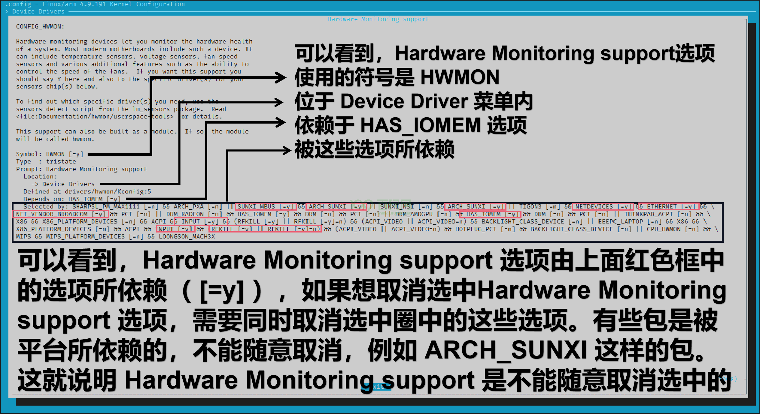

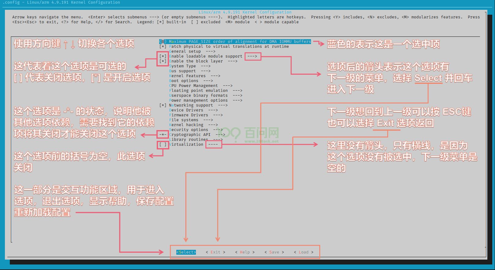

Kconfig 配置方法​
如果你需要修改内核配置项,可以在TinaSDK源码目录下执行 make kernel_menuconfig命令来进入到 内核的菜单选项界面。
对于menuconfig是一种图形化配置工具,这里以 kernel menuconfig 作为例子,讲解如何使用 Kconfig 基础配置方法。
首先我们进入 kernel menuconfig
ubuntu@ubuntu1804:~/tina-d1-h$ make kernel_menuconfig
export MAKEFLAGS= ;make V=ss -C target/allwinner menuconfig
make[1]: Entering directory '/home/ubuntu/tina-d1-h/target/allwinner'
make[2]: Entering directory '/home/ubuntu/tina-d1-h/target/allwinner/t113-100ask'
rm -f /home/ubuntu/tina-d1-h/out/t113-100ask/compile_dir/target/linux-t113-100ask/linux-5.4.61/.config.prev
rm -f /home/ubuntu/tina-d1-h/out/t113-100ask/compile_dir/target/linux-t113-100ask/linux-5.4.61/.configured
export MAKEFLAGS= ;make -C /home/ubuntu/tina-d1-h/out/t113-100ask/compile_dir/target/linux-t113-100ask/linux-5.4.61 -C /home/ubuntu/tina-d1-h/out/t113-100ask/compile_dir/target/linux-t113-100ask/linux-5.4.61 HOSTCFLAGS="-O2 -I/home/ubuntu/tina-d1-h/out/host/include -I/home/ubuntu/tina-d1-h/out/host/usr/include -Wall -Wmissing-prototypes -Wstrict-prototypes" CROSS_COMPILE="arm-openwrt-linux-muslgnueabi-" ARCH="arm" KBUILD_HAVE_NLS=no KBUILD_BUILD_USER="" KBUILD_BUILD_HOST="" CONFIG_SHELL="bash" V='' CC="arm-openwrt-linux-muslgnueabi-gcc" menuconfig
make[3]: Entering directory '/home/ubuntu/tina-d1-h/lichee/linux-5.4'
--define-variable argument does not have a value for the variable
scripts/kconfig/mconf Kconfig
configuration written to .config
*** End of the configuration.
*** Execute 'make' to start the build or try 'make help'.
make[3]: Leaving directory '/home/ubuntu/tina-d1-h/lichee/linux-5.4'
make[2]: Leaving directory '/home/ubuntu/tina-d1-h/target/allwinner/t113-100ask'
make[1]: Leaving directory '/home/ubuntu/tina-d1-h/target/allwinner'
#### make completed successfully (6 seconds) ####
image-20220711114825681
image-20220711115616754
image-20220711120726186

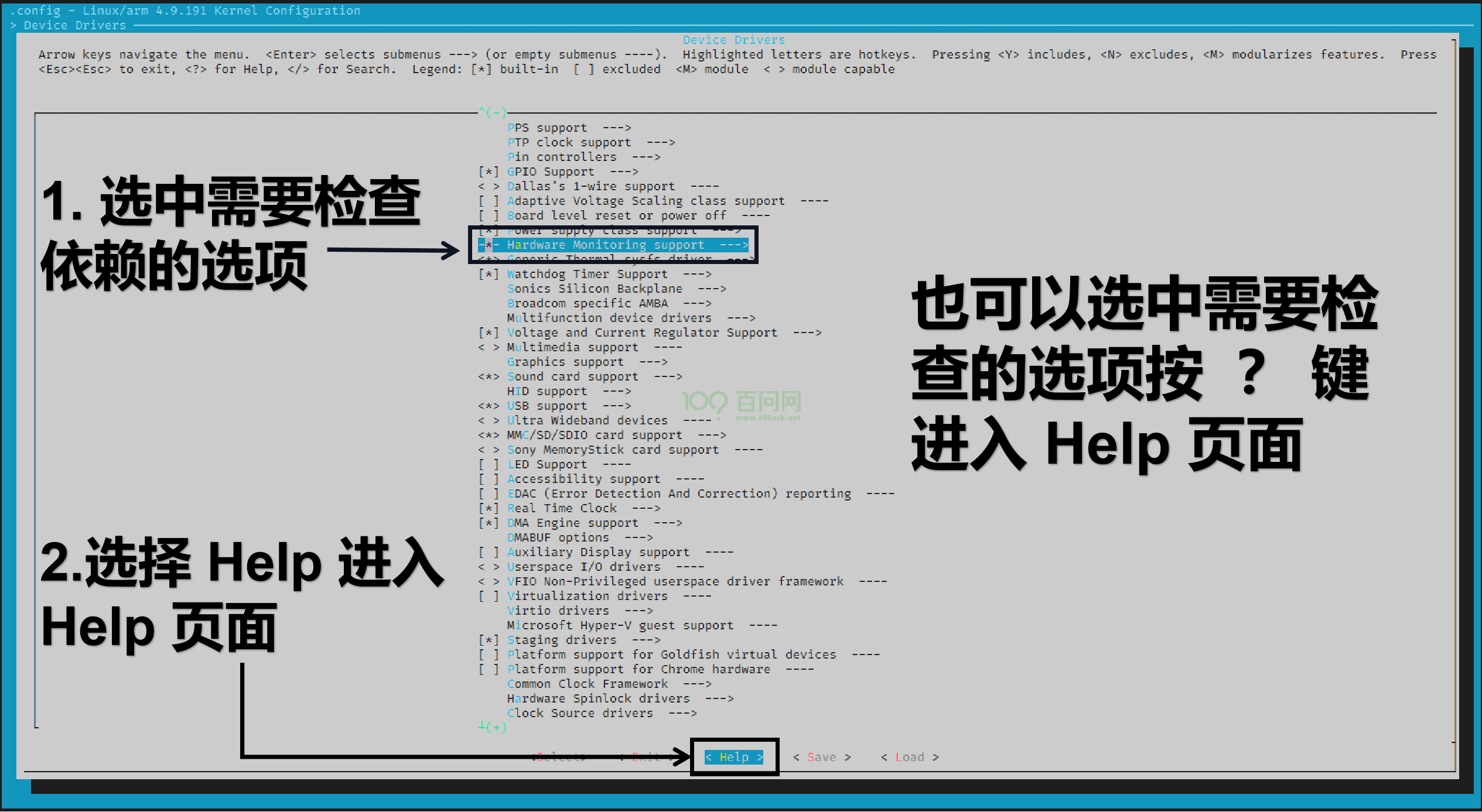

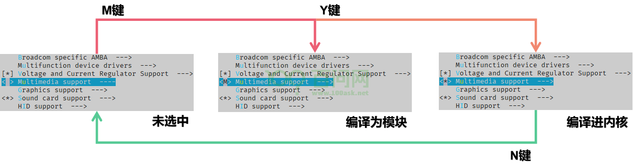

也可以使用 Y M N 键来修改选项:
image-20220711120802522
image-20220711125703598
image-20220711125333193
在 Kconfig 的界面中按 / 键,进入搜索页面。
image-20220711130647390

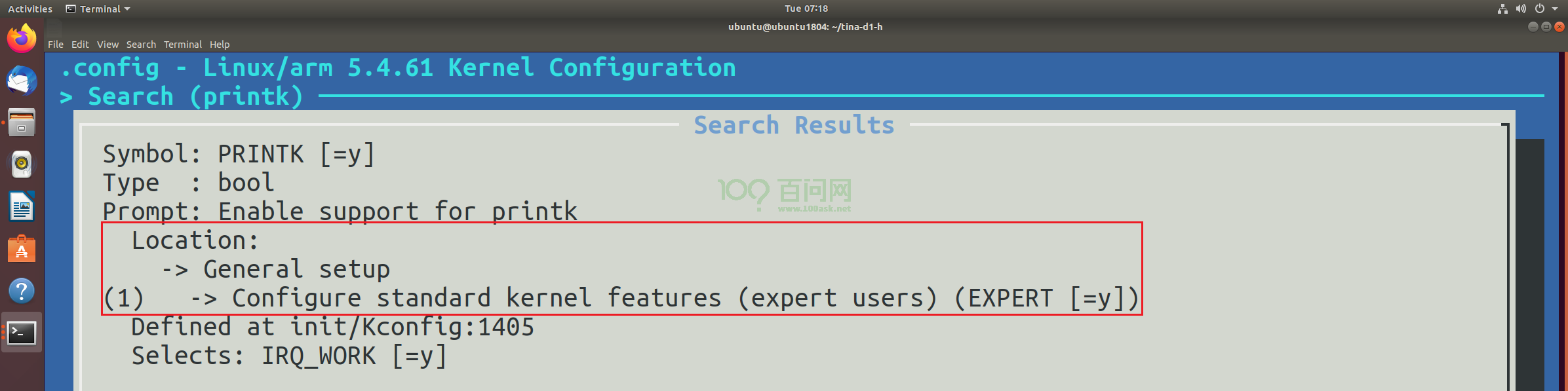

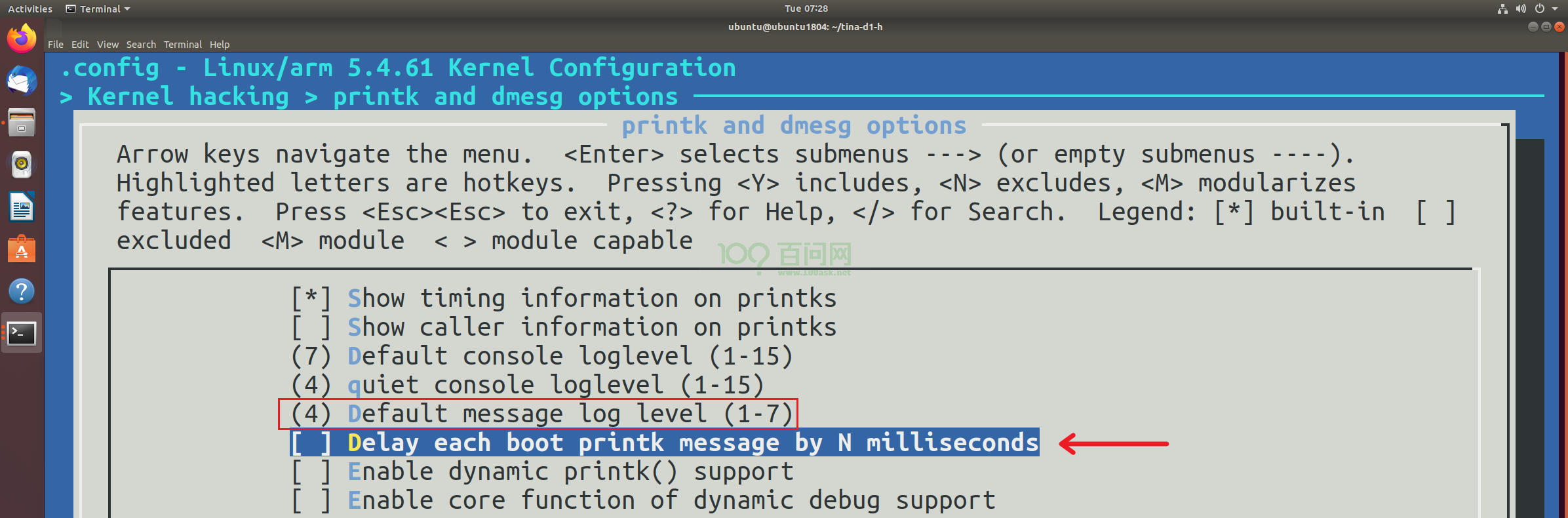

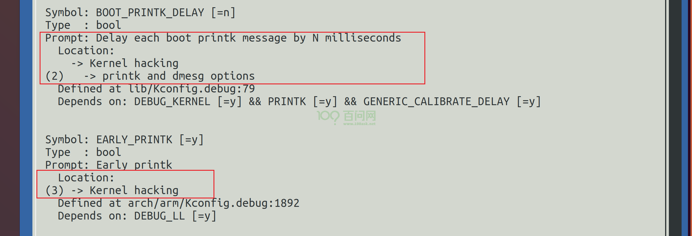

调整 kernel打印等级默认为7
image-20240312191931286
默认不知道 kernel的printk打印等级配置在哪里,通过搜索得到路径,上面那个 Enable support for printk 并不是 我们要找到的 调整系统默认打印等级的配置项。继续往下,找到了 一个 Delay each boot printk message by N milliseconds 通过查看这个也不是,这个配置和是 用来 调整 因为系统信息显示过快 而 调整 每个 printk的打印间隔时间的。

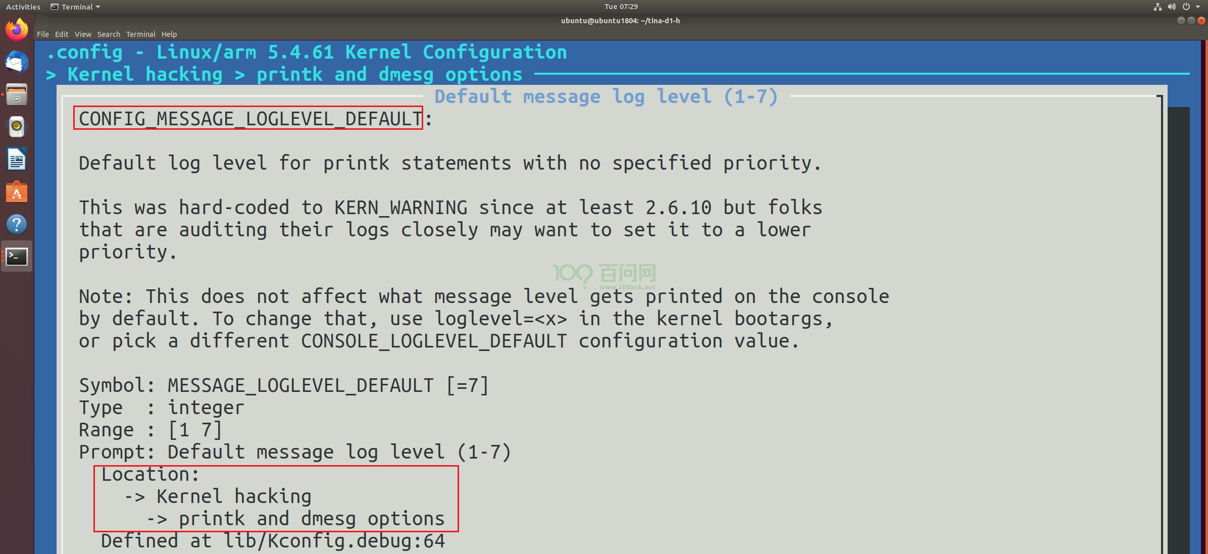

还有一个 Early printk 看着类似,但是也不是,不过我们可以大概 知道 是在 Kernel hacking这个 类目内,
image-20240312192151522
image-20240312192917118
image-20240312192951669
CONFIG_MESSAGE_LOGLEVEL_DEFAULT
image-20240312193020080
image-20240312193152213
image-20240313095953057
image-20240312193802741

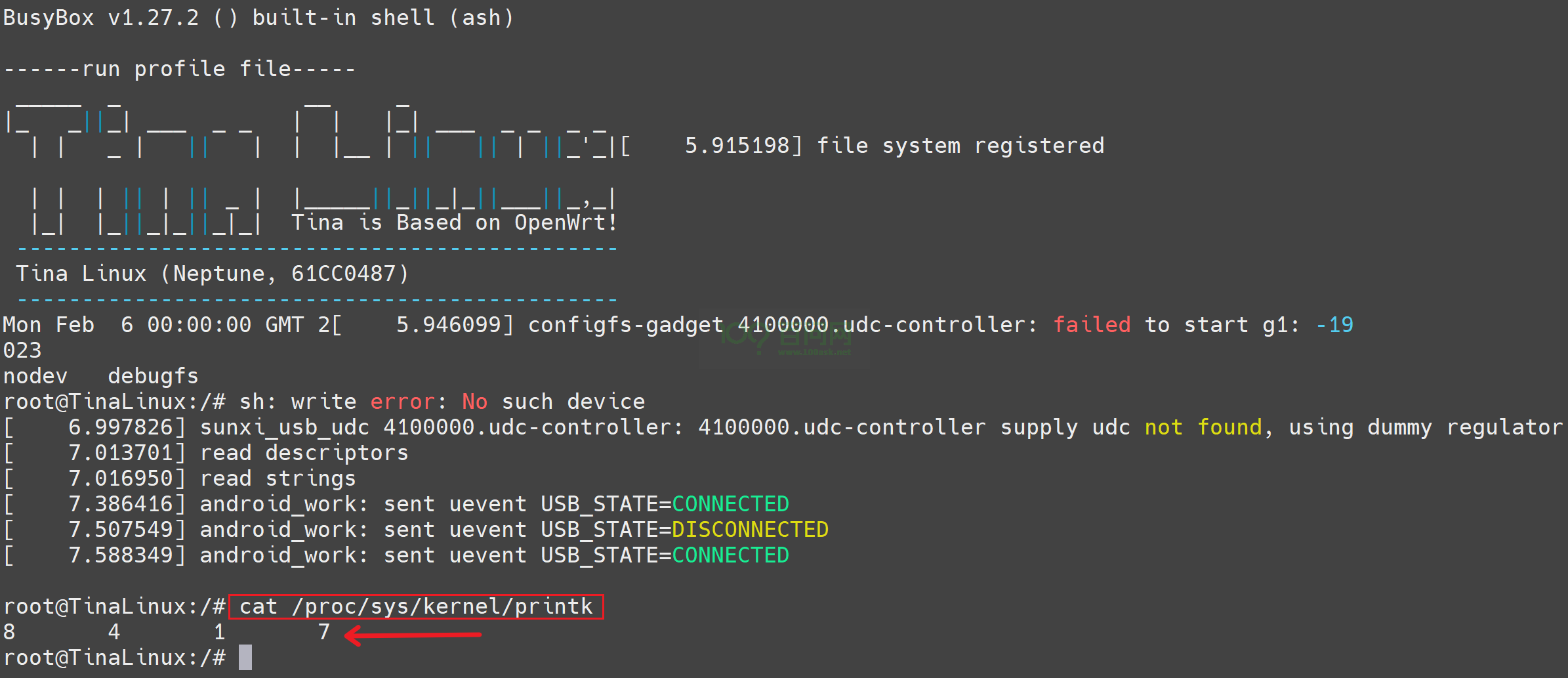

启动系统后,执行 cat /proc/sys/kernel/printk来查看系统默认是否已经把 printk 打印等级调整到了最高。如果如下图 红色箭头 7 所示,就表示已经成功。
image-20240313100416526
